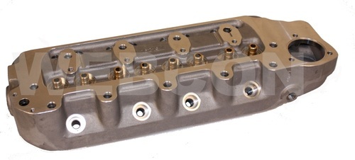

The port for the temperature sender is at the right in this picture under the thermostat housing.
If you search eBay for “Marina water temperature sender” lots show up, like this one part number GTR101
