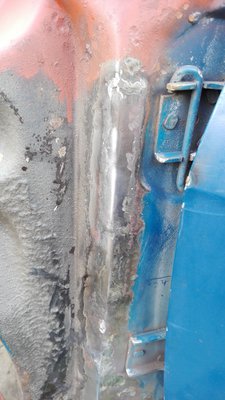

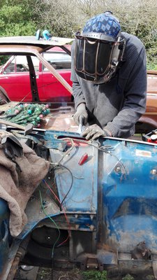

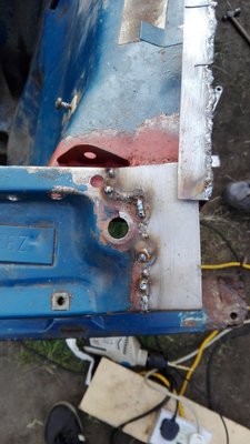

Today we did a bit more on Rusty. My brother made a new panel, and welded it in, for the wing/bonnet runner to sit on and repaired the curve where the wing goes. I made a patch for the end on of the (think it's called) slam panel and welded that in. We did grind all the welds flat but I didn't get any pictures of that. Just need to repair one little bit then the headlamp panel can go in :thumbup:.

Brother at work
Brother at work
Brother's work 1
Brother's work 1
Brother's work 2
Brother's work 2
My work
My work

Post by Morris McKinnon » Sun Apr 09, 2017 2:49 pm
Good job on the welding. Scuttle corners, they always go around there. A job I need to get around to doing. It looks like the previous owner of TDT lobbed a ton a filler there. Has a nice rusty orange crack running from the glass to the bonnet lip now! Wish I noticed before I got it painted.

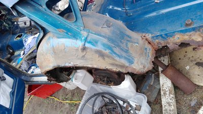

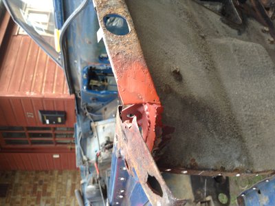

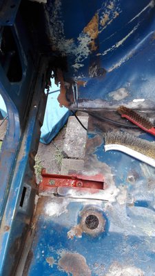

Yesterday and today we had a bit more progress on Rusty before we ran out of welding gas (got more coming tomorrow ;)). Repaired the bits where the wings weld to, the front valence and even got the new headlamp panel in :thumbup:. Also, my brother made a start on the passenger floor. We're getting there, slowly :lol:
