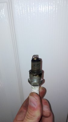

Well after about a month of the car starting rough (sounded like it was on 3 cylinders), and for the first 2 minutes running with lack of power, I thought I'd better investigate. Found the problem....
Now starts sweet and has it's power back .
