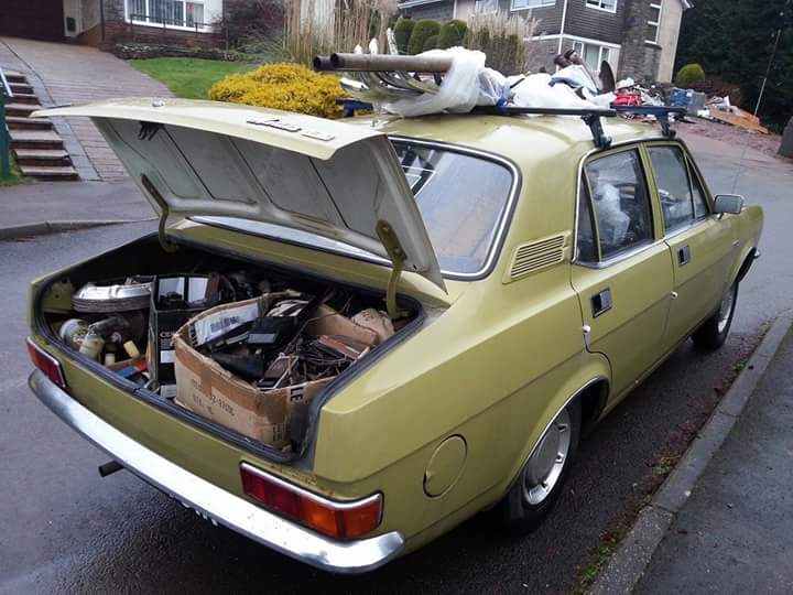

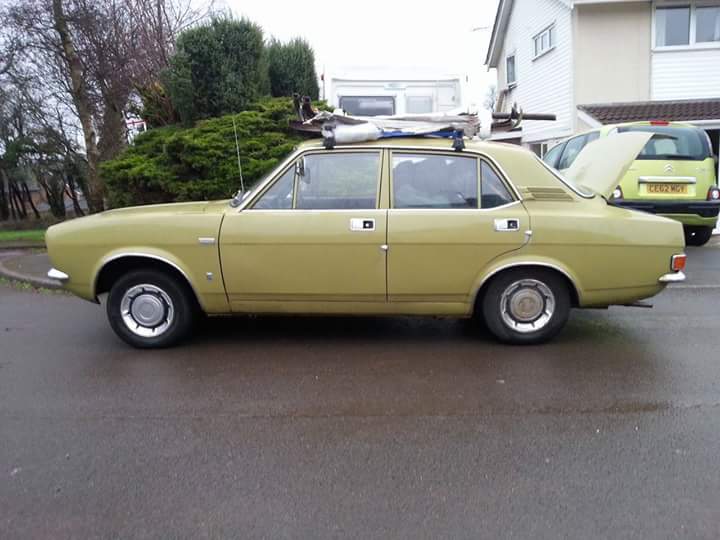

Post by Morris McKinnon » Mon Jan 30, 2017 8:24 pm
Drove up to Newport in PTH with my mate today to pick up what I thought would be one or two Marina parts.
..should have hired a van!
Post by locost_bryan » Mon Jan 30, 2017 8:55 pm
Just as well the Marina has a decent sized boot. ::):
Post by Morris McKinnon » Mon Jan 30, 2017 10:08 pm
locost_bryan wrote: Mon Jan 30, 2017 8:55 pm Just as well the Marina has a decent sized boot. ::):
If I can't find a B&B at this years nats I know where I'm kipping! :lol:
