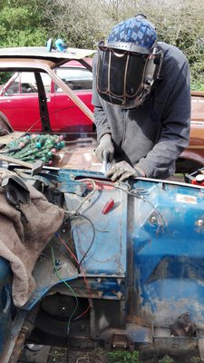

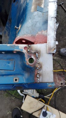

Today we did a bit more on Rusty. My brother made a new panel, and welded it in, for the wing/bonnet runner to sit on and repaired the curve where the wing goes. I made a patch for the end on of the (think it's called) slam panel and welded that in. We did grind all the welds flat but I didn't get any pictures of that. Just need to repair one little bit then the headlamp panel can go in
Watch this space
-  Brother at work
-  Brother's work 1
-  Brother's work 2
-  My work
Alex
				Posted: Sun Apr 09, 2017 2:49 pm
				by Morris McKinnon
				Good job on the welding. Scuttle corners, they always go around there. A job I need to get around to doing. It looks like the previous owner of TDT lobbed a ton a filler there. Has a nice rusty orange crack running from the glass to the bonnet lip now! Wish I noticed before I got it painted.
