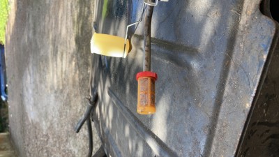

Found the cause of the breakdown on the way to the nationals. The filter attached to the sender unit in the tank.
The question is as I have a filter further upstream shall I leave it out?
Should stop this again!
Post by ClaytonSpeed » Wed Jul 28, 2021 8:05 pm
I’d clean out the tank and fit a new filter. That doesn’t look too pleasant!

Post by 1972TCCOUPE » Wed Jul 28, 2021 8:31 pm
The inside of the tank is now clean,it seemed covered in a sticky grey film. Filter has cleaned up a treat. I’ll leave it in. A coat of schutz,a new breather pipe and back in again. Thanks Ben

Post by JubileeNut » Wed Jul 28, 2021 10:05 pm
That did look very gluey?
I had to wash out my tank as some over spray was in the filler neck which the petrol removed and ended up on the filter in the tank.
I have just bought an endoscope so I think I will have a look in my tank and see what my filter is like! I have lots of uses for this thing including checking the inaccessible roof gutter to see if its blocked :thumbup:
Just got to get a high reach vacuum now so I don't fall off a ladder emptying the gutter and end up in A+E.
Wonder if the modern fuel mix does this or a combination of fuel types?
I remember that a BMW windscreen washer filter went all slimy and blocked and it was due to mixing different types of washer fluid. Never had it happen since but now I only use one type.

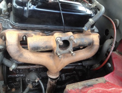

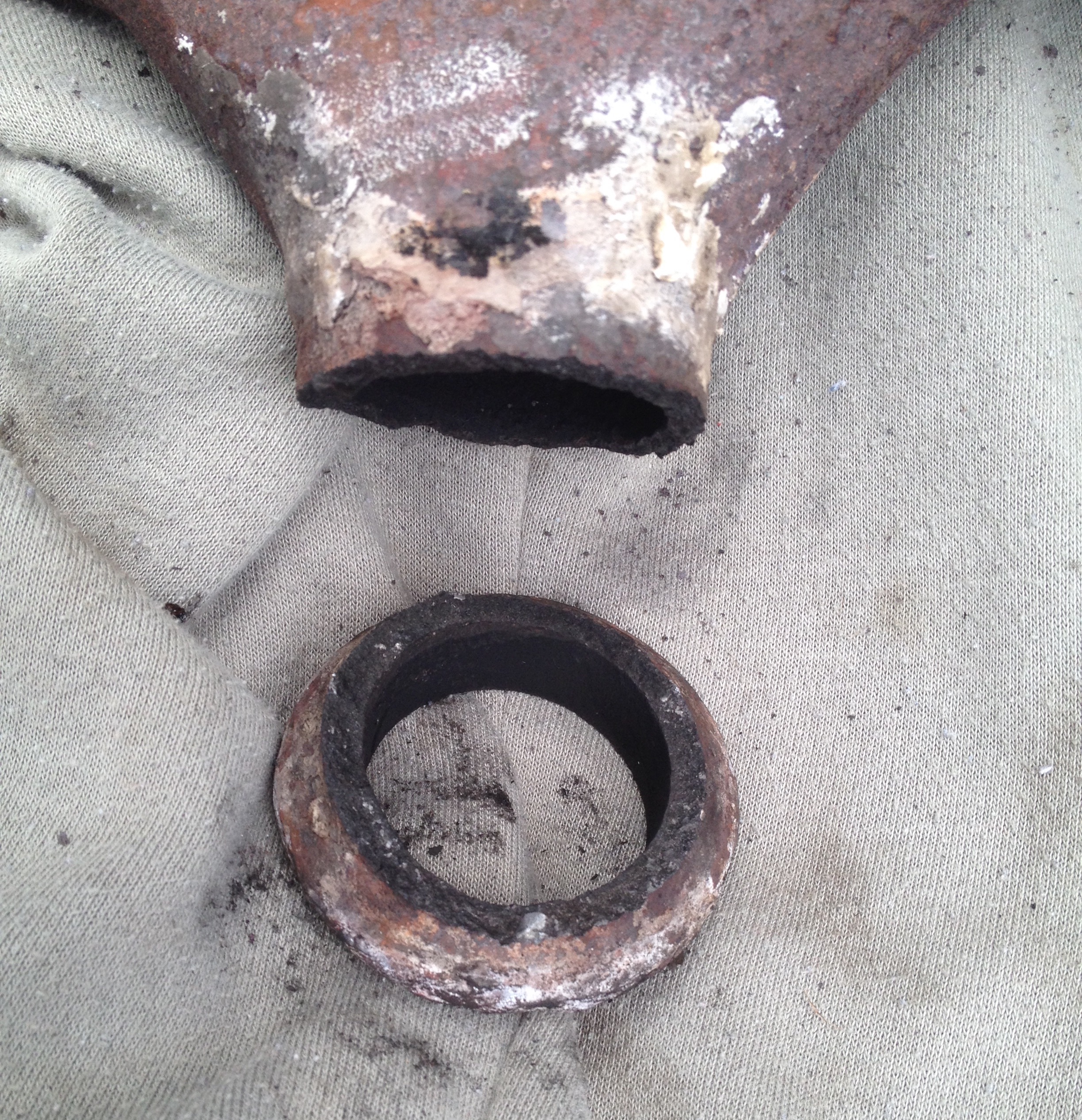

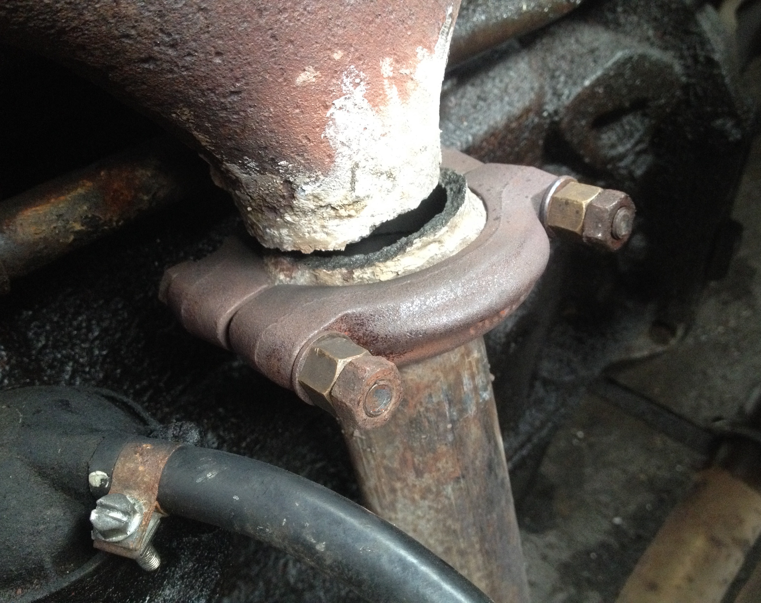

Unfortunately on the drive home I drove too close to a very high mini roundabout grounding the front of the exhaust and splitting the manifold right above the down pipe clamp.
As such I urgently need a replacement single carb 1.8 manifold if anyone has a spare?

Post by ScreamingLordStokes » Sun Aug 22, 2021 6:31 pm
Replaced the broken manifold with the one Josh kindly sent.
Odd that three gaskets are needed for the carb spacer block and bracketery but only two are provided in the gasket kit.
